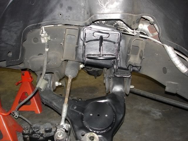

aaronhebert88's avatar
aaronhebert88
this is a chevrolet im shure its pretty much the same
i have a few more in my profile
soontobelayed
aaron is yours torsion bars in the lower pic
