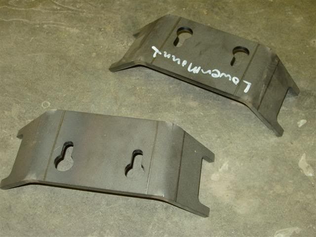

i am mounting my airbags on my bars on the side of my frame. i have a top mount for it. can i just drill a hole in the link bar to mount the bottom of the bag to it. it only has one bolt hole i need help please cause im tryin to get this finished before next friday. thanks
mindlissmetalfab's avatar
mindlissmetalfab
Yes that will work. Just make sure you are using sturdy enough material for your bars. If you have space you could also run a mount like this with a single hole. (I offer both styles, just dotn haev a pic of the single hole ones)

i would run some sort of bracket on it. it seems like it would want to lean too much on a round surface.

i would run a plate on top the bar and mount the bag to it. its going to distribute over a bigger area. check how i did mine in my profile i ran my bag on top my lower bar too

would it make a difference if i ran a 2x2 square bar from suicidedoors and mount it straight to it with out any bottom mount just a top mount.

I did it that way. I welded a bag plate on the bar though.

if you use a square bar you'll be fine, but a round bar really needs a plate, or else you'll end up breaking the bolt(s) mounting the bag....
