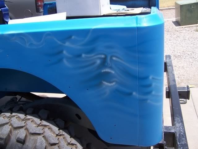

Yea and there's nothing worse then seeing the edge of your mudwork in a paintjob especially if you've got countless hours of airbrush time in it. The dupont rep told me that their ultra productive urethane primer has a etching agent in it.But it cant hurt to have a coat of self etch under your mud work
