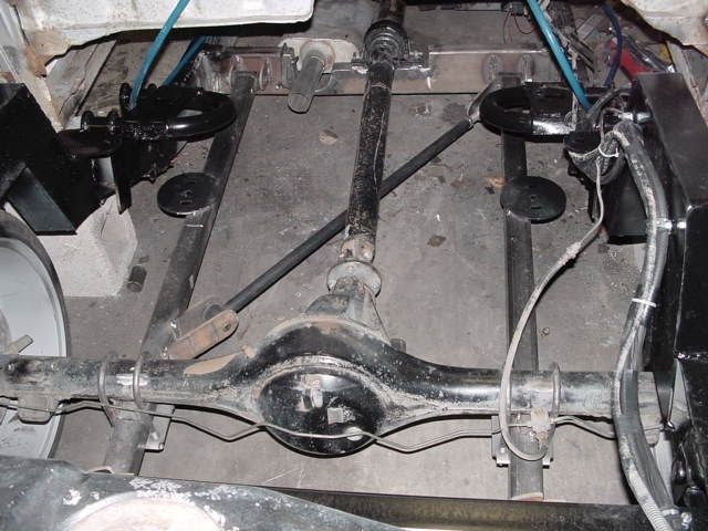

you will get a lot of people talk shit on here about 2 links but when set up right and used right you wont have any problems here's a look at mine
i didn't run a pan hard bar per say but i did use a track bar set up no side movement and it will do side to side without lifting a wheel put 400 miles on it so far and most of that was an the highway doing 85 threw the mountains

there is nothin wrong with a 2 link if its set up right but i say no 2 panhard bar because it moves ur rearend 2 the side when u lift it if u run A 2 link def run a track bar instead

a 2 link with a watts link in place of the panhard works great with no side to side movement

i love my 2 link. i tried a conventional 4 link and a reverse triangulated 4 link before i decided to gige a 2 link a try. i love mine now. i dont have much if any side to side movement in my wheels travel.
