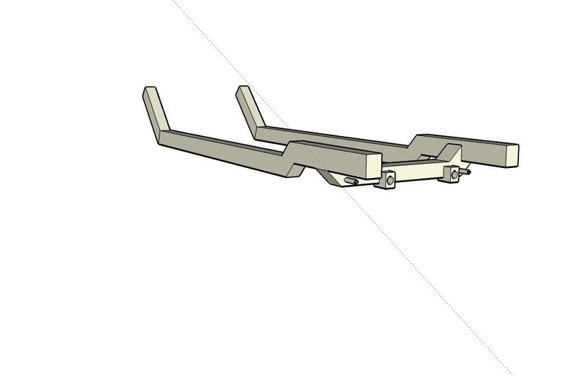

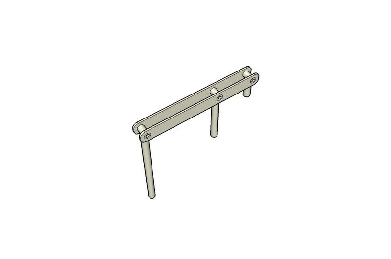

also, here is the canti roughed in, but will be boxed fully, and run along side the frame rail down into the upper arm, through it, and mounting on the lower. Just not sure if I should use a normal "bar end" or a spherical. Any in site on that? I can make it so the spherical doesn't have much side to side play, but still gets the rotation it needs. Just wonder if it makes a difference as far as how smooth it all works once in order and going through its travel.
i have changed a few thing on the front suspension design wise, nothing as for critical measurements but the kick up was 4x4.25 in that pic, and i got it back down matching the 3x4 crossmember. should be working on it shortly. the reason the upper mounts arent on there yet is because i dont know where exactly they will end up, but i do know where they belong height wise.
