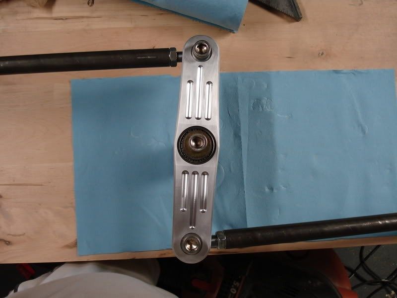

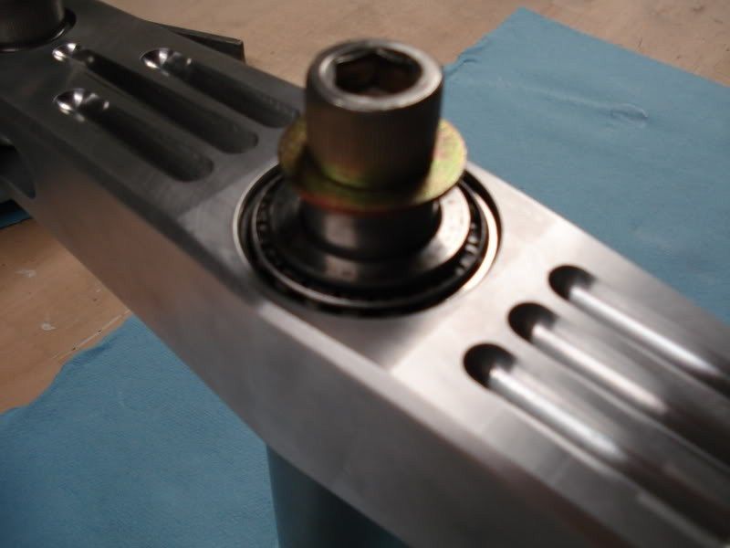

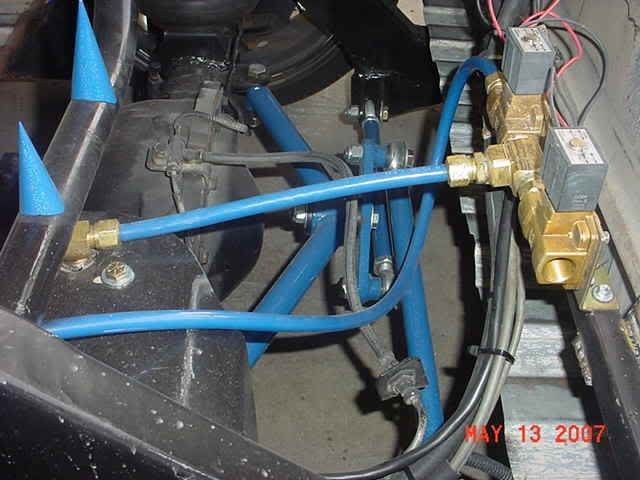

my boy werm bought one from him its pretty bad ass it needed some tweeking but turned out fine couldnt find better pics of it but here are a couple after i powdercoated it
Ill give him a call and see if he has any better pics to post

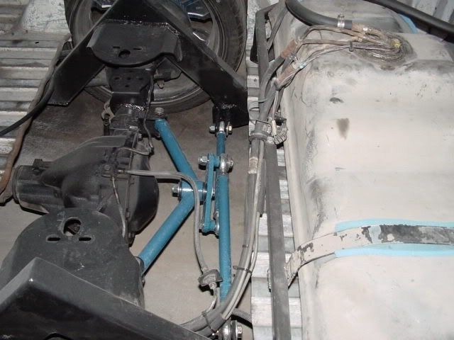

i wouldnt be upset, i posted a watts link i built like a year ago on here, and it looks just like the ones you had in the classifieds, except the poly bushing in the center, i used a poly flex joint to eliminate binding and wearing out the bushings.....
Low_SST's avatar
Low_SST
i like those designs but hate the fact that poly bushings are used. mark you know you want one like mine. Its a knock off TP centerlink rollin on 1" id trailer bearings.
