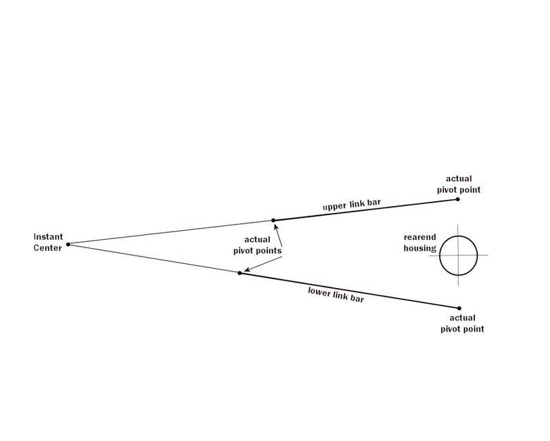

With a triangulated 4 link, do all 4 bars need to be level at ride height or just the lower bars?
974door
The lower bards need to be parallel with the ground. The uppers need to be just a little lower in the front.
974door
here is an example. If you look under the 4-link forum that was done on link bar set-ups, it goes into alot of detail.
