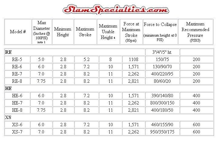

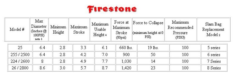

is a re5 slam bag the same size as a 2500 firestone, and does anyone know how much the lift is on the firestone 2500
CC
creative concepts
no, re6 is.. re7 is the 2600 bag. re6 gets 8 inches of lift in a 1:1
layedouton22z
There is a comparison chart on one of their websites I believe...try airliftcompany.com I can't remember were it was for sure....sorry if no help
