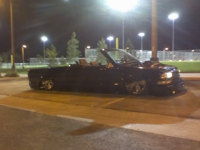

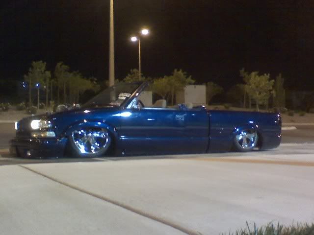

well i did it last night...i cut about 2 inches above windshield to leave the support for the pillars.. the doors i left 1/2inch of the door post and cut the ex-cab portion even with the top of the door posts. and i just removed the rear glass... i'm going to have to trim everything down some more for everything to be even with the top of the door and even with the bed in the rear... i'll be making templates for the door pillars and everything else tomrrow and have it all cut and welded in sometime next week.. then another week for bodywork ... and i'll be gettin a fresh cowl hood, new stock bumper, and mey seats shortened and re-wrapped, and all hopefully in time for drop zone...

hopefully i do this right the first time...
http://i35.photobucket.com/albums/d167/tc02/topless.jpg
http://i35.photobucket.com/albums/d167/tc02/topless1.jpg
i'll take more pics of the pillars and everywhere it's been cut... hopefully you guys can give me some cool ideas on how to finish it up... im also thinkin of sheetmetal interior panels for the x-cab portion of the truck...
