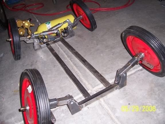

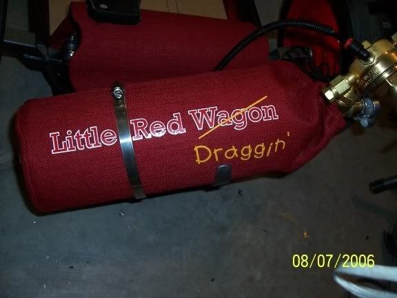

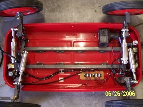

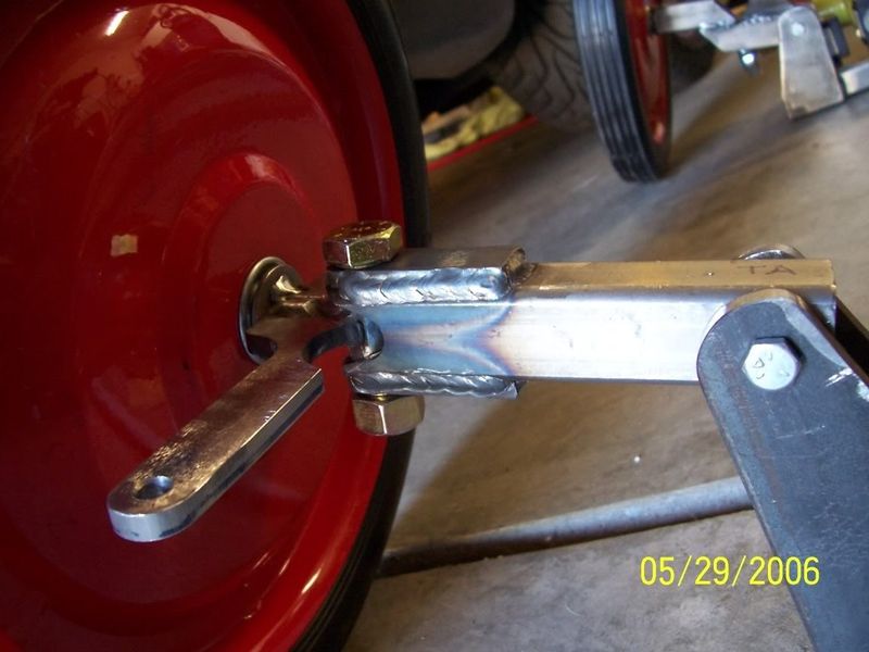

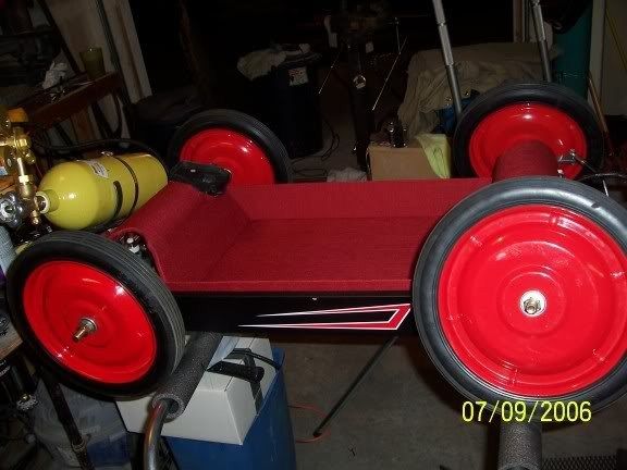

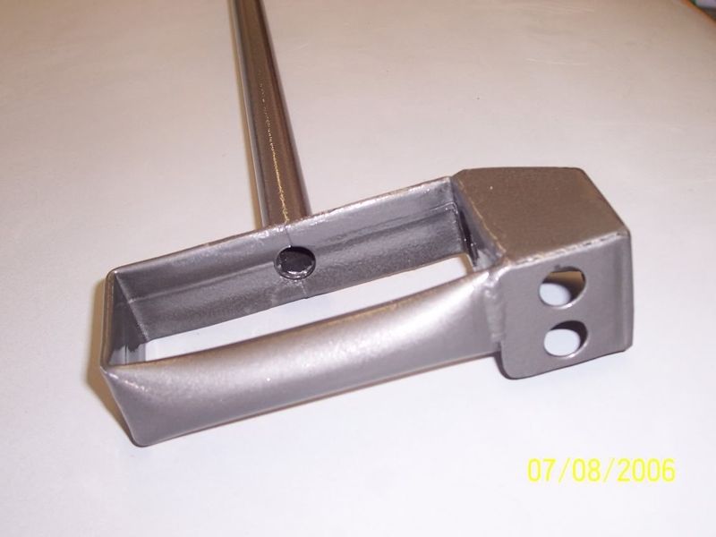

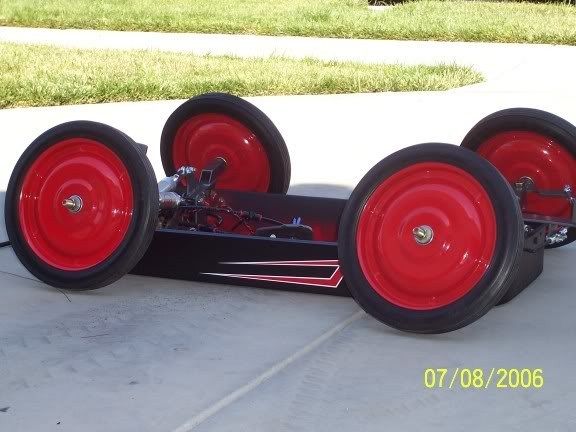

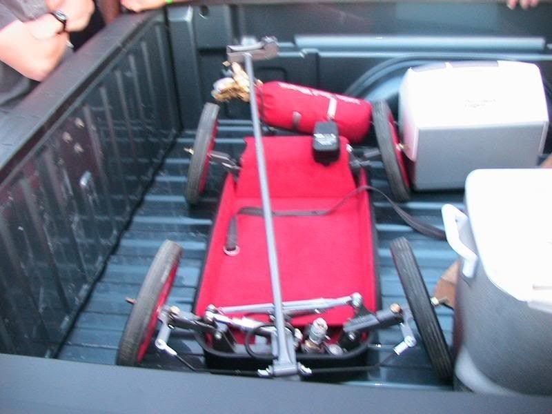

mine - same one as in the pic above.
I am in Dangerous Toys - i just run the web site baggedbirds.com
Bimba 1 1/4" cylindersnitrogen bottlefaux red suede (pics show tweed)1/4" line1/4" Asco valvestube framebtoom of a Craftsman 12volt drill. So its rechargeable. the valves don't care as long as its 12 volts.
heres an old vindeo of it in action with no weight in it to drop it down
http://s26.photobucket.com/albums/c112/baggedbirds/Blakes%20wagon/?action=view
