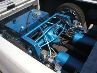

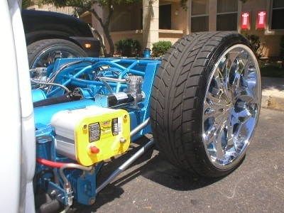

Primer was used on mine, than just a PPG single stage. its just a frame after the trucks put back together u wont see much of it anyways. U can't see mine except through the wheels and wheel wells. Also no sanding or anything just sprayed it let it dry for a day or 2.

That frame looks really good.
As far as the coating on the frame, it looks like new steel, so it will have a light grease coating on it that prevents corrosion. This most definitely needs to be completely removed before attempting to spray anything on the frame. I would clean it a few times with mineral spirits or lacquer thinner. Clean it until the rags stop coming off black, then clean it again and run across the whole thing with a tack rag before shooting any primer.
