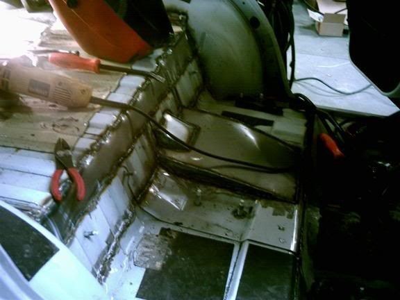

Lowpuppy
yeah i made the new mount for the wishbone to connect to and made the lower foward link mounts. used 2door gas tank straps to mount the tank. took 5/8" out the driveshaft though to keep it from pushing all the way into the trans. the floor wasnt that bad to patch up either. i cut the hump off of that one that way it would lay full frame. heres a pic with the inside all patched up and the seats went back in with a lil bit of work
