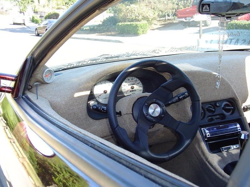

any tips or tricks i should know before i start?? any help would be great
SoCalDelinquentZ's avatar
SoCalDelinquentZ
in the hard curved spots.. spray a section at a time let it dry then pull the tweed around the curves and keep it in sections letting it dry in between... also.. clean the dash real well before
1lowtaco95
thanks man. your s**t looks good
whynotfab's avatar
whynotfab
Yea that looks really good
