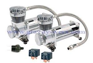

instead of a single 550 why not get a viair dual pack of 380s or 480s?

I would run a viair 480 dual pack on it. You would have some GREAT fill times with that. Whatever way you go We have the ALL the Viair Dual packs IN STOCK as well as silver and the purple AZ's. Same day shipping and tracking numbers.

id go with a edc or VIAIR 480 DUAL PACK w/pressure switch and relays $359.95 FREE SHIPPING!!!!
StreetNshow.com
i wouldnt go with the 550 , i would go with the Viair 480 dual pack also, but if you had to choose between the two,i would go AZ

I would run dual Viair 420c's man. They are only slightly less CFM than the 550c but are cheaper and physically heaps smaller. They also draw way less power than the 550c. 420c's are 2.54 CFM, the 550c'c are 2.9 CFM and the 480c's are only 1.76 CFM. The only downside is they are only 33% duty cycle but ive never had a 420 shut down on me, and i run them pretty hard.
