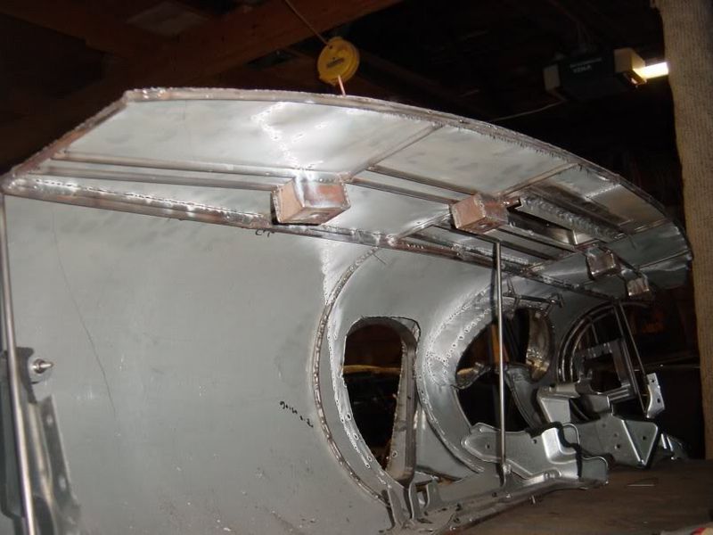

Here's a pic of the back side of the dash. I used the lower dash support from the factory dash and built it from that point. I framed it with 1/4 rod then sheeted it. theres 6 mounting point. The 2 factory ones on the bottom, and 4 on top.

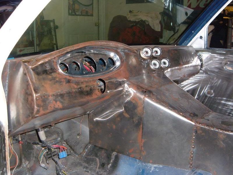

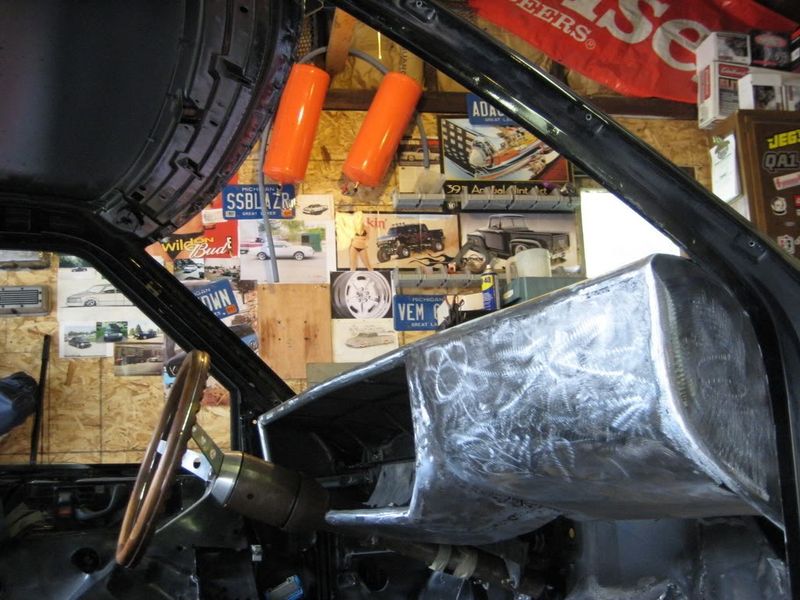

these are two that we have built in house
