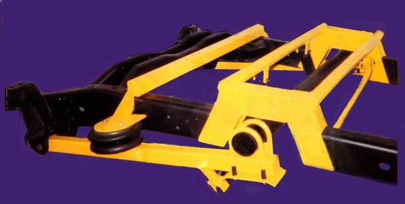

ben_shady1
Ekstensive 2 link is the best and easiest way to go.. Slide it over your frame.... weld it on... easy as that...

Lol yeah FSC.com is faithful as hell to the 6 link. I would do either suicidedoors or kp's parallel 4 link with the panhard bar, and an 8inch notch and bridge kit from suicide. run you about 500 bucks for notch kit and kp link. then just raise the gas tank about an inch, they usually section the actual crossmember and move the mounts upward. for 20's i think u can run a 2inch lower cup and 3 inch upper cup and that will put you good lift and still hammer the frame. (im not positive on those dimensons, i run 22's) only other thing is the tranny crossmember bolts stick way lower than the frame u will need to come up with a new way to mount the crossmember unless u dont mind it laying at a slant and your not planning on draggin.
ben_shady1
Killer rides has it for $650... I dunno how much it runs straight from Ekstensive ya might get it a lil cheaper from them... Still not a bad price considering how easy it is to set up..
