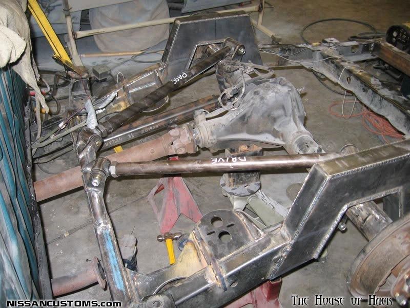

i'm getting ready to have my rear done on my 96 hardbody and i'm trying to see how the lower bars will look.do any of you guys/gals have any good pics of your setups for some ideas. can i use my factory front pearches or how do i set those up. thans for any ideas.

If you use the factory purches your bars will drag. You could get away with it if you trim the purch down and drill a new hole up higher.

yea do what he said and run your upper bars to frame rails behind the rear end( reverse triangulated). just be sure to take some channel steel and box your rails were the links will mount. oh yea dont forget to raise your gas tank.

use the factory front hanger cut it flat and redrill it thats what i did and it works great
