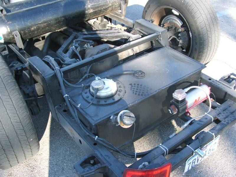

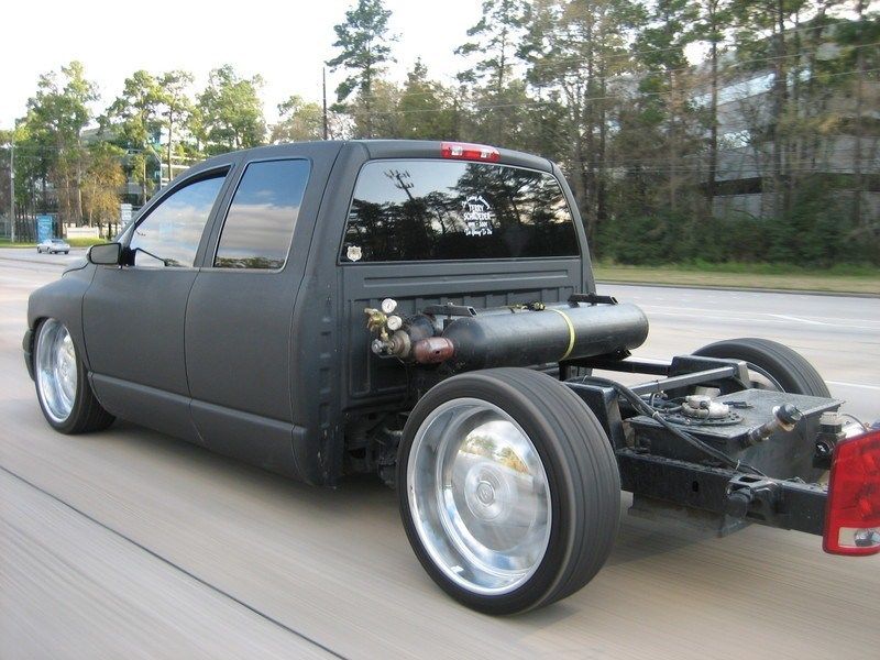

I built a fuel cell out of 16ga and used the stock sending unit. Total cell cost me less than $75. Coated the inside with Por-15. Never had any problems at all out of it. All the stock gauge and console info worked great.

You have to extend 4 wires and the lines. Go to autozone and ask for 5/16 fuel injected fuel line. Don't get regular line and can't hold up to the pressure. Get about 5 feet just to be safe. It will slide over the stock fuel lines and then clamp snug. Don't clamp to much or it will leak. Don't use barbs either, they will never seal up.

napa has fittings to slide right on to the factory sending unit & you can just replace the whole line instead of splicing in.
