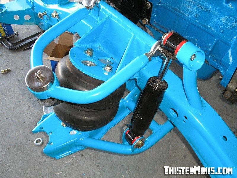

I really like the can do arms, what ball joint do they use? dode anybody make somthing simalar using factory ball joint. and another question do you use the factory control arm bushing in the frame looks like that would let the wheel track back as it rolled foward? anybody got any or any closer picks of the setup.
dragontoy22r's avatar
dragontoy22r
He uses screw type balljoints, GM I think. I've heard they articulate much better, and looking at mine, I would say they do. Much better than stock either way.

who is "he"? and I was looking more along lowers that do away with the strut rod.

I have the uppers only
TwistedMinis's avatar
TwistedMinis
Eliminates strut rods.
dragontoy22r
"He" is Steve. Steve is CanDo. I've just got racing bars with super pivots running reverse to replace the strut rods. Uses 2" and 1.5" 4-link tabs.
