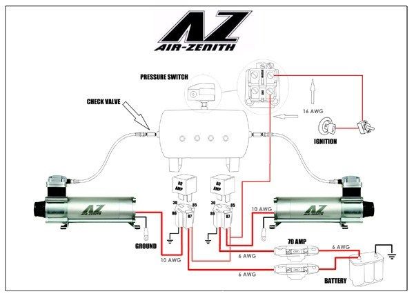

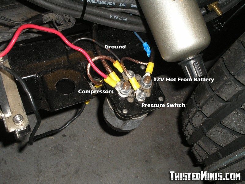

i know its a stupid question but i was wondering if anyone of you have pictures of a wireing diagram to run 2 air zenith compressor. i have one relay from suicide doors and the other is a universal relay can`t finger it out please help
Rob Clayhill's avatar
Rob Clayhill
im running 2 AZ's but not sure how to help you because i have 2 stinger relays from suicide doors wired off of eachother from a distribution block, pretty simple to wire up but not sure about your universal relay...
