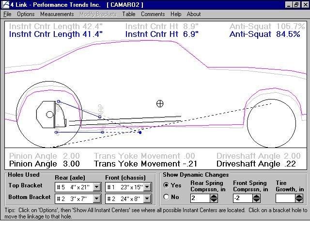

A 4 link is simply a term used when referring to 4 bars that hold a solid axle in place and provide a given range of free travel; setup in all defferent variations and used in TONS of different applications-from rock crawling to drag racing. The bars pivot on each end...
a 4 link would replace your leaf springs but would not directly replace them; a 4 link provides no suspension(it does not suspend the vehicle's frame from the axle)
The solid blue bars below are the Camaro's 4 link bars-running from the top and bottom of the axle and to 4 mounting points on the frame.
