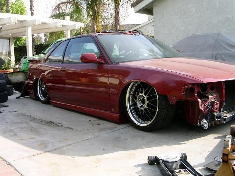

check out my ride on my profile.. i had cylinders on my integra and it drove great... its not like coilovers or anything but if your not into racing and driving like an ass all the time than you should be fine...i enjoy the ride on it alot better than my tien springs i have on my 92 integra now... lol thats why it shall be on air soon... lol
