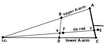

I hear of a lot of people that are swaping out their strring boxes to go with a rack. I'm curious how many are actually the right width for their application. This diagram shows how to measure for proper tierod length.
