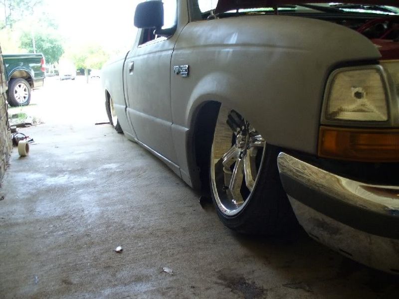

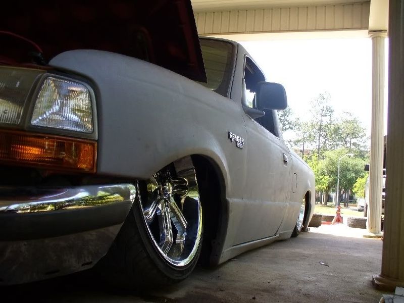

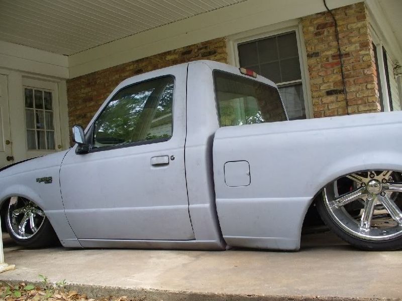

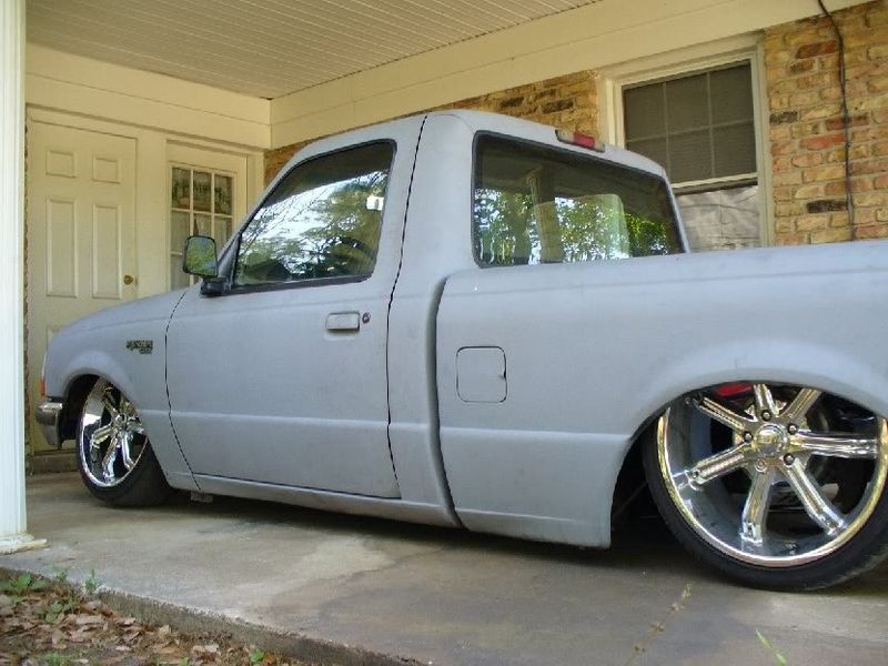

Here are some pictures of the truck.
Before the bodydrop.
After the bodydrop.
We just got everthing cut. No welding is done yet.
still2low4urho's avatar
still2low4urho
looking good so far so is it traditional or stock floor under the cab
Dropmaster's avatar
Dropmaster
Traditional. I wish I had a shop and the time to learn how to do a SF. We done this bodydrop right where it sits under the carport.
