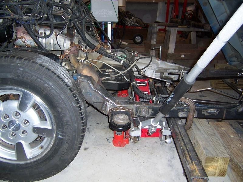

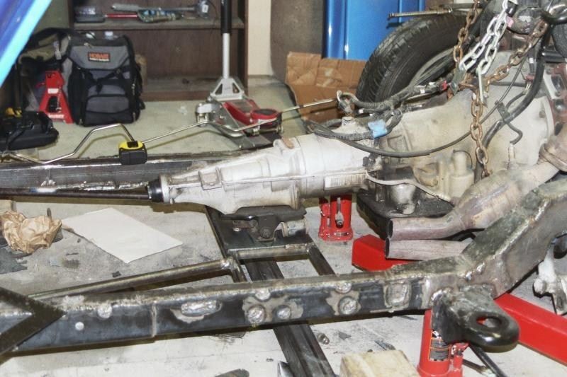

not a chevy but it is Z'ed 2"s hope it helps some
incognito 1's avatar
incognito 1
incognito 1
I put in gussets top & bottom then plated the sides & top & bottom...
