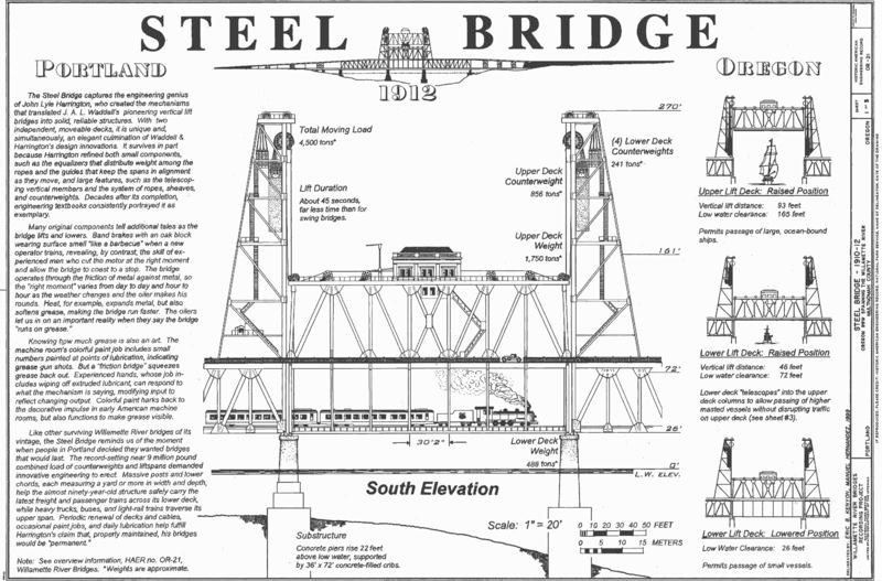

but if its 2 thick, somethings won't flex with a standard frame and can cause cracking. Not common, but it can happen.
Or just build a big one that can hold allot of weight...
