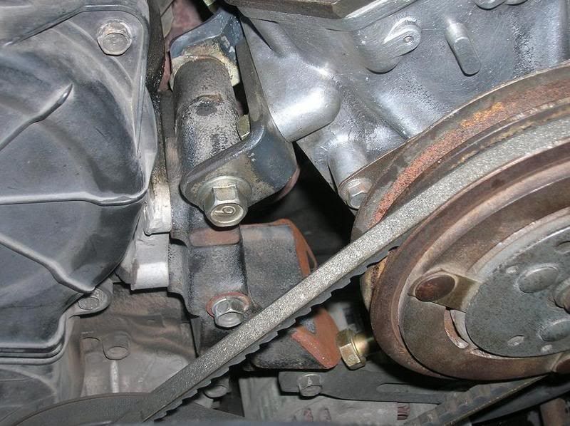

i finally got around to putting a york onto my isuzu. i didnt have to spend hardly anything, most of the stuff i had lying around, (including the compressor). i ended up using the old bracket from the smog pump to mount my york in the same place. i had to cut up the old bracket and bend it, but i got them to work. the only problem i had was having tension on the belt, so we welded a nut to a piece of angle steel, and bolted the steel to the bottom of the compressor, then used a bolt to press against the old bracket to put tension on everything.
i still need to run the power wire to the pressure switch, and airline to the tanks, but the hard part is done. i might redo the tensioner part, im going to see how it works out, but heres a couple pics

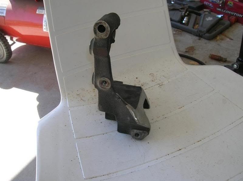

heres a closer picture
this is the bracket thats factory and bolts to the engine block, i cut the far end of it off for clearence purposes

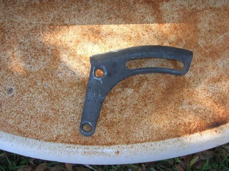

this is the upper bracket the held the smog pump in place, i cut the slotted part off, and heated up and bent the other piece and re drilled it to bold the front of the compressor too.
the back part of the smog pump bracket was also used the same way, but i didnt have a picture of it.

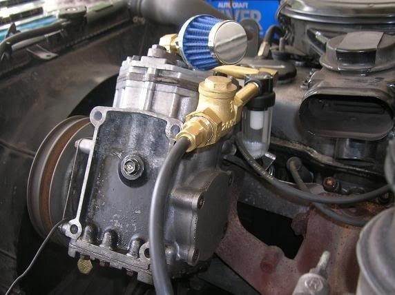

so heres the final pics.... i went to good ol' home depot and bought a flapper check valve and a little water trap built for a little compressor.
