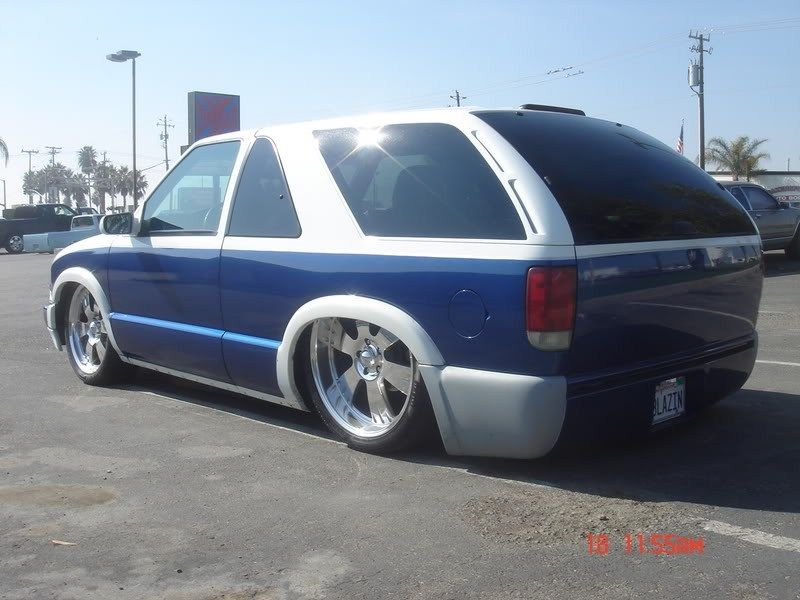

didnt get the rear seats to fit in this one but its tuckin 22's out back!
