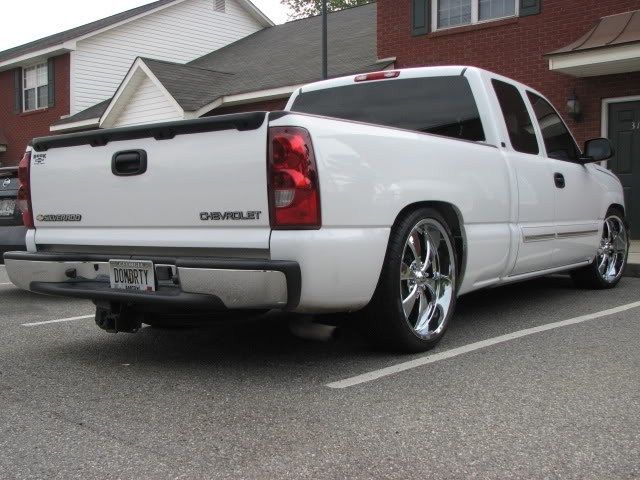

It depends on drop and tire size. I just put some new shoes on my silvy with a 4/6 drop.22X9.5 +35mm on 265/35/22They tuck just fine I seen some bagged silverados running the same offset as me, just cant run a wider tire up front cuz it will rub. I did roll my rear fenders and I have plenty of room. These higher offsets are available for the 07 tahoe. The only bad thing about them is they are lugcentric, but my wheels came with hubcentric rings so I was good to go.
