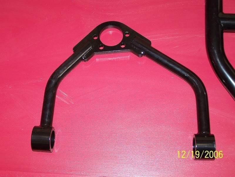

It is possible but not recomended. The angle on the ball joints in a stock arm is pretty severe when trying for a 22. It is a good idea to run control arms made to lay on big wheels.fixture built

699.99 for SSM members (750 more for non members) & yes they are in stock ready to ship.
