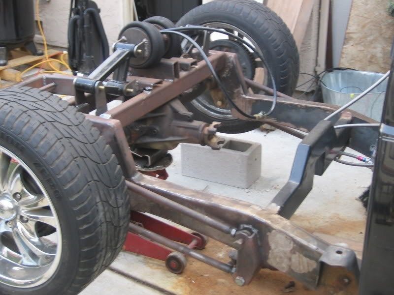

not mine.... i have a kp 4-link... pretty easy setup. longer the bars the better. paralel to the ground at ride height harder to screw up then a tri 4-link. make sure you run a panhard or watts with it...

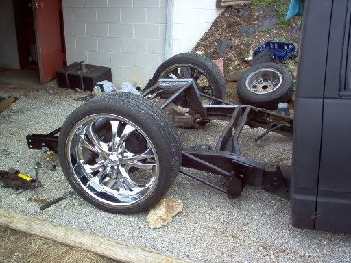

Here is mine back in the day...KP 4bar with a Panhard rod to keep axel centered. If u roll a Parallel and are going big wheels and plan on driving it frequently u might consider a watts link setup over the panhard rod.
