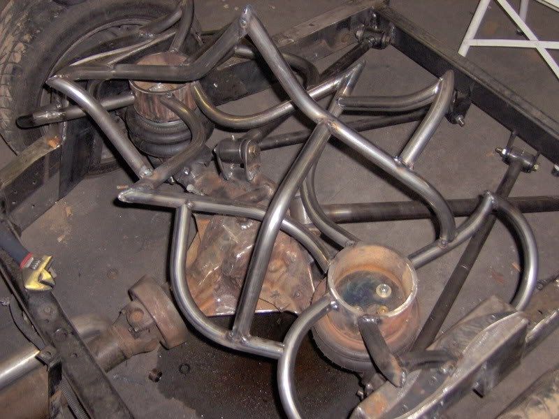

I am getting ready to set up my rear bag and suspention links, I need some ideas from you guys...

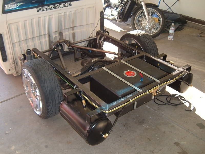

slamdamazda
HERES MINE.
slamdamazda
It doesnt look like this anymore i have beefyer lowers now and everything is painted.

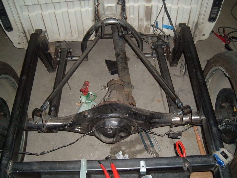

farmer joe's avatar
farmer joe
Edited: 3/1/2007 2:02:42 PM by farmerjoe84
heres the rear setup on my buddies 77 luv. the frame on it is basically the same as the pups.

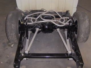

Marshkid1's avatar
Marshkid1
Edited: 3/1/2007 2:08:04 PM by Marshkid1
Here's my first and only setup, if you do the bags on the bars, make sure you center em, my bushings twist alot, and its' only been one summer.

slamdamazda
yeah....my lowers twist too. need to center them bags up or itll keep on twisting.

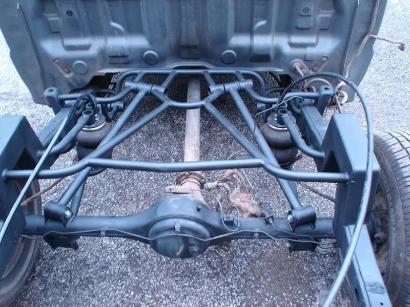

PUPon20s's avatar
PUPon20s
I have my bags centered on the bars and it does just fine. The main x-member was a little weak so now I am rebuilding it out of 2x2 1/4 wall. Other than that, it works great!!!
