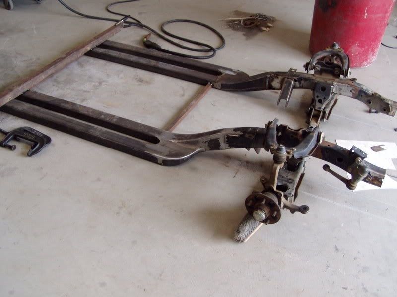

i was wondering where the usual 3/4 frame would start...
i wanna build a frame with 2x3 laid FLAT, with 2 sets of rails, inner and outer, body mounts between the two, and a canti setup with the outer rails ending at the bag mount.
i am askin this because i am thinkin of takin from where the front clip starts to bend outwards, cut it there... then i would go straight back from that, all the way to the backend, wiht the outer rails forming the body mounts n stuff...
its hard to imagine what i'm sayin unless i draw it out... i know...
i'll draw it up tomorrow after work...

i was talkin bout somethin like max's frame... thats tight...

tim usually it would start right at the firewall and flow towards the rearend from there...i think that answered ur question
laydoutb26's avatar
laydoutb26
YES!!! that answered my question bro...
i want mine to look somethin like this... it is out of proportion by a little bit and it will look better when done.
the rear end gets its lift off of the cantilever bags mounted outside the rails... also, instead of the tank being between the rails... there will be 2 skinny tanks outside the frame next to the tank.
The red is the new frame with the blue being the 4 link... and black being the axle...
here it is...
