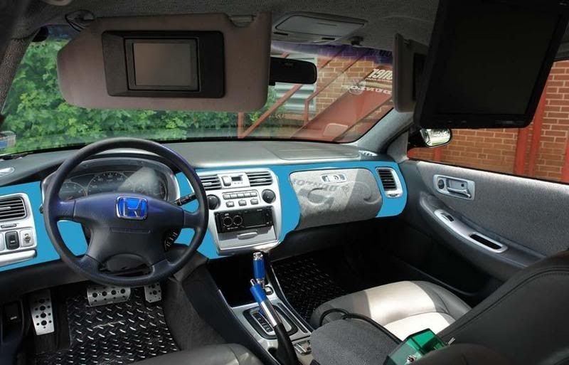

someone please tell me how to remove the middle section of the dash from my 98 accord.what all is involved.goin to take out and finish the hypnotic swirl theme on it.why can't i get the damn center console out.any tricks.got every bolt i can see and it will not budge.

the middle section that wraps around the vents,glove box,radio cluster,and the gauge cluster.got my glove box done,but need to finish the theme on the middle section.trying to find out if you can just take that piece out and not the entire dash.thanks

thanks accord2show.know how to do that.i'm talking about the actual dash.trying to remove the piece in blue.

You might not like this, But you gotta pull the hole dash! there are screws behind it that hold the top of the dash and that "blue piece" together!
jrock74's avatar
jrock74
DAMN!!!!!!!!!!!!!!!thought i could get around doin that.
