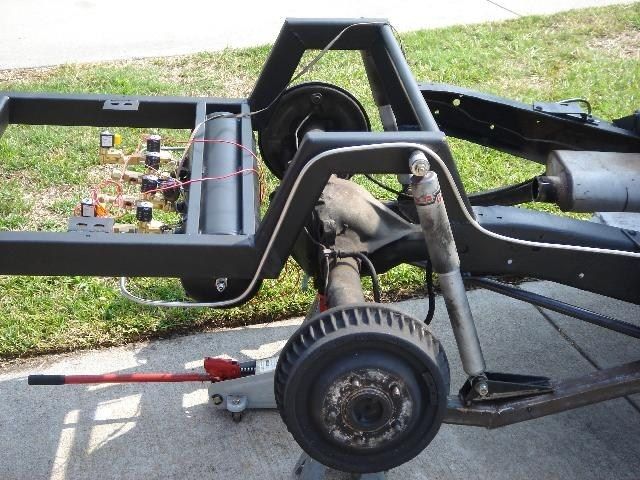

I just made from the notch back. Instead of the frame stepping in and getting narrower, it is now straight all the way back. It only took a day to do and it cost about the same as one of Kp's crooked notches. I maybe have $100 in the steel. I used 2x3 box tubing with 3/16' sidewall. It will lay body with 22'sThere is about three inches left to go down in this picture.
