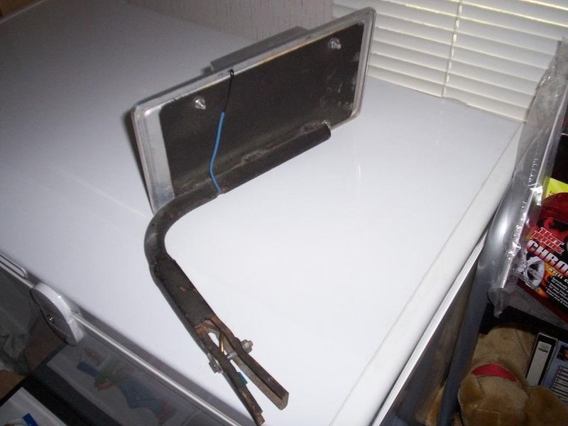

i dont know anyone that sells them but they are easy to make all you need is a torch and some small tubing

The one on the back of my car is made out of 1/2" pipe and a piece of 3/4" square tubing. Bent the round tubing to a 90 deg. angle, welded a piece of 16 gauge plate to it to mount the tag to, and slid the other end into the 3/4" square tubing welded them together and cut a notch into square tubing verticaly and drilled a hole horizontaly. Then bolted it to the tow hook on the back of the car.

oh mean as, wud you happen to hav any pics of it close up?, so its less confusing lol

Pics are worth a thousand words. The lighted plate frame is from Billet Specialties, but I'm sure that you can get a cheaper one.Originally posted by Sivik

Lets try that again with the correct address. http://i161.photobucket.com/albums/t224/CUTTIN-CUZICAN/100_0459.jpg
