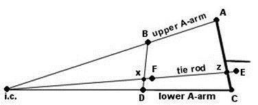

Reguardless what changes are made to the suspension geometry, there is only one way to eliminate "bump steer." If your suspension does not follow the guide lines set by this diagram, you will have toe issues. The tie rods might be higher or lower, but the line drawn from the i.c. (instant center) is very important. By moving a pivot up or down will change the i.c. and thus the proper tie rod position.
