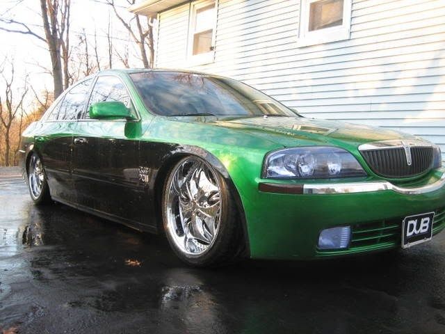

you should look into HOK (KBC) Kandy basecoat. They have it in organic green. It's darker like an emerald green. You would base the whole truck black first, tape your two-tone break and spray the KBC on the other half. The stuff is awesome. It really mimics a true kandy finish
seanb's avatar
seanb
^^ yea, what he said. HOK bascoat Kandy is the easiest "candy" to spray. Looks like a candy but without the two step process.

Dude that looks goo! Definatly a color im plannen to use!
