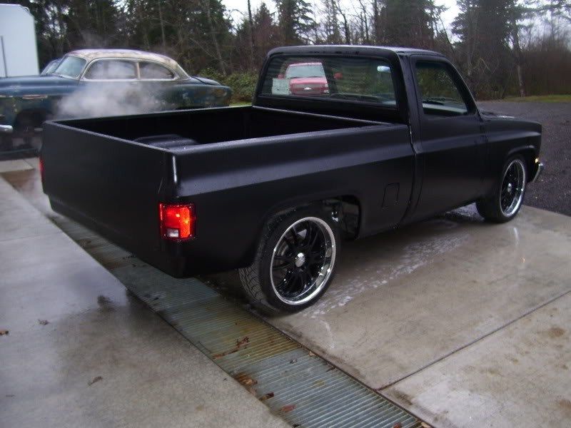

how are you guys mounting your solenoids for your shaved doors. show pics if you have them.
