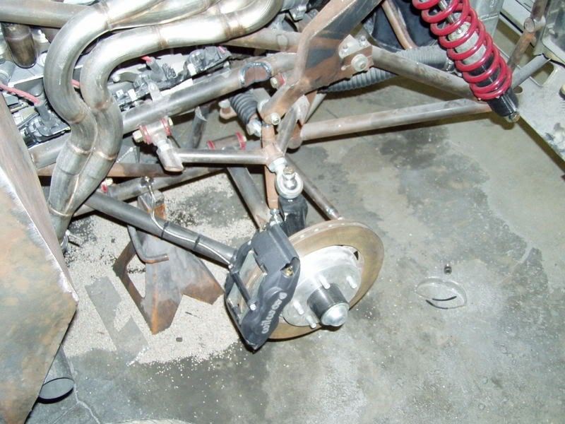

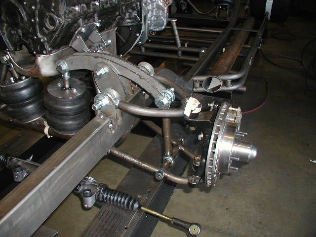

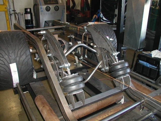

We did one on a chassis we built a couple years ago. Check our profile. I believe you can see it in one of the pics. The reason that we did it that was out of necesity. Had no room for the bag in the traditional place. It worked well though.

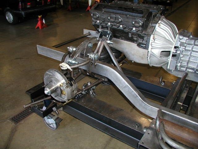

the setup on that fullsize is nice, Is that some kind of splined shaft?? what from??
PF
Precision Fabworx
yea, it is a splined shaft. 1 3/4 hardened steel. We found at an industrial supply store along with the female ends. We just did a little machining on the ends of the shafts to fit the bearing (heim ends) and built the arms off of the females

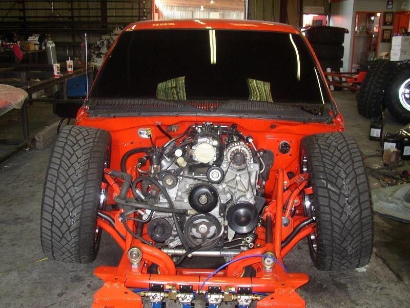

Bryan's on his new C10
and on the rear!!!
PF
Precision Fabworx
Why is the motor so high on that C10?
