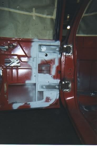

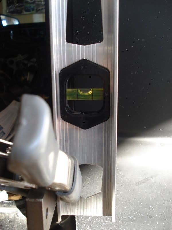

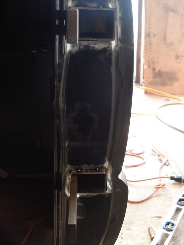

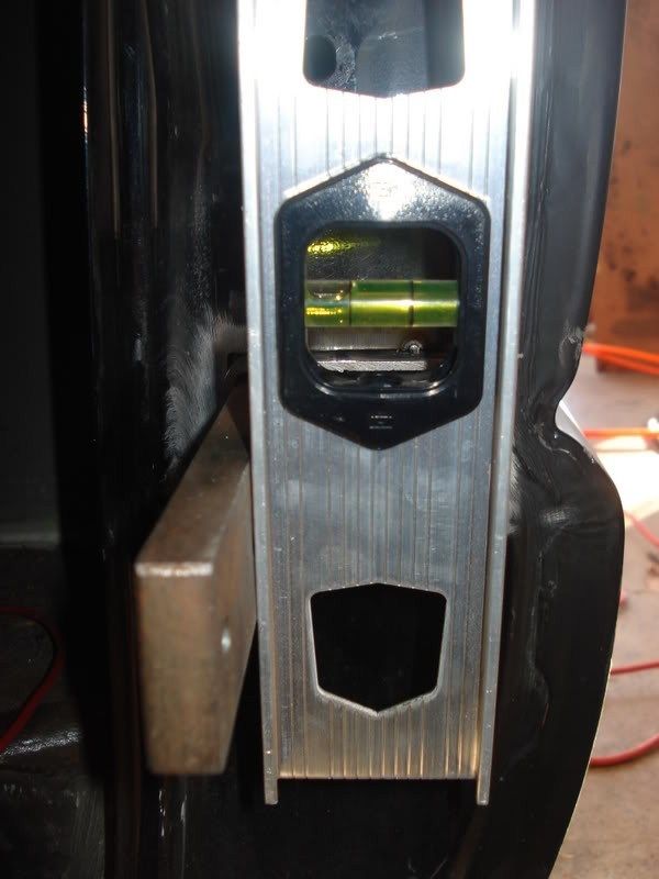

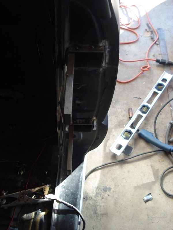

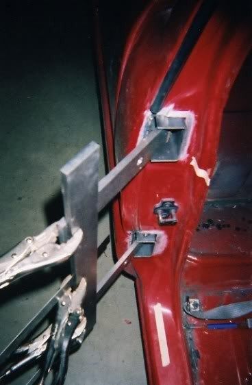

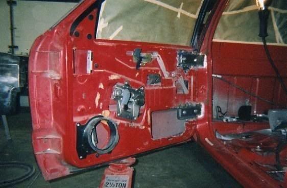

Ok ..Im usually on the s10-forum but I decided to post here for the 1st time...sorry for it needing to be for help...but ...well Ive been at this for a small time and I just started meshing the hinges into the jambs...HERES MY PROBLEM... when I put the hinges outwards as though the door is open I check it with my leveler and it says its level....THAN...when I close the door its off....what the hell...Im not sure if anyone else ran into this ...I have my cuts almost exactly to SUICIDEDOORS.."HOW-TO"...and I've looked at countless others....The hinges also look as though they go a bit farther than they should...I took pics...lmk...thanks ...
HERE...IS WITH THE DOOR HINGES SWUNG OPEN AND WITH A LEVELER ATTACHED....
http://i102.photobucket.com/albums/m119/My5t3Ry21/DSC03389.jpg
NOW WITH THE DOOR CLOSED
http://i102.photobucket.com/albums/m119/My5t3Ry21/DSC03395.jpg
HERE ARE ANGLES OF THE HINGES AND THE PLACEMENT OF THEM...
http://i102.photobucket.com/albums/m119/My5t3Ry21/DSC03390.jpg
http://i102.photobucket.com/albums/m119/My5t3Ry21/DSC03391.jpg
http://i102.photobucket.com/albums/m119/My5t3Ry21/DSC03392.jpg
http://i102.photobucket.com/albums/m119/My5t3Ry21/DSC03393.jpg
http://i102.photobucket.com/albums/m119/My5t3Ry21/DSC03394.jpg

if they are level when the door is open but not when shut. that means the hinges are not 100% perpendicular to the ground.
my5t3ry
so what does that mean ...do I need to make the hinges move towards the cab counterclockwise to raise them up?

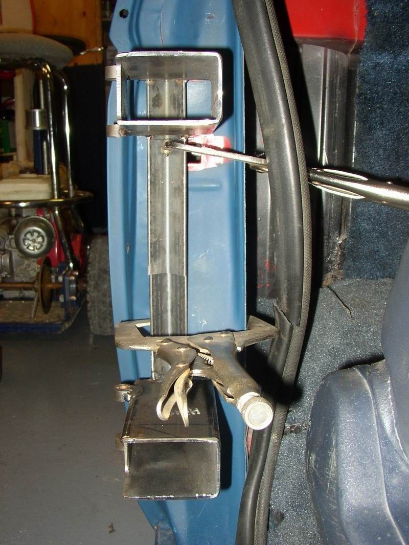

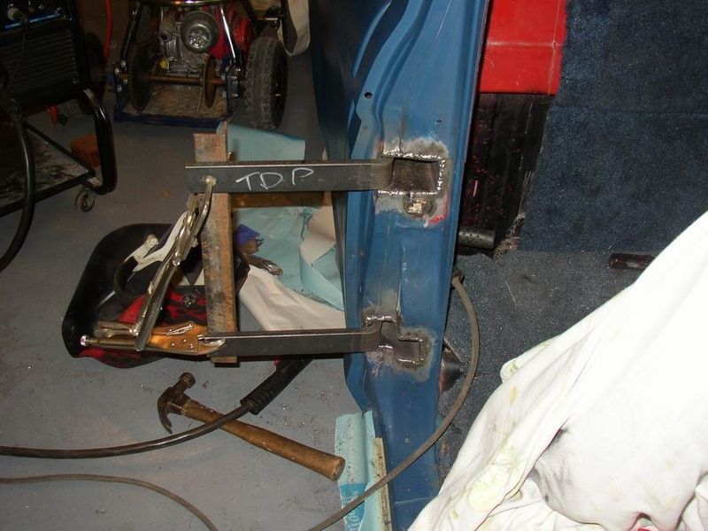

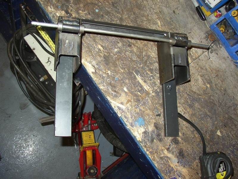

Here ya go.
twistedsdime's avatar
twistedsdime

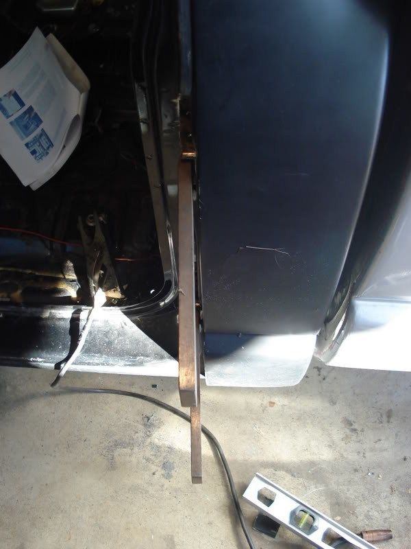

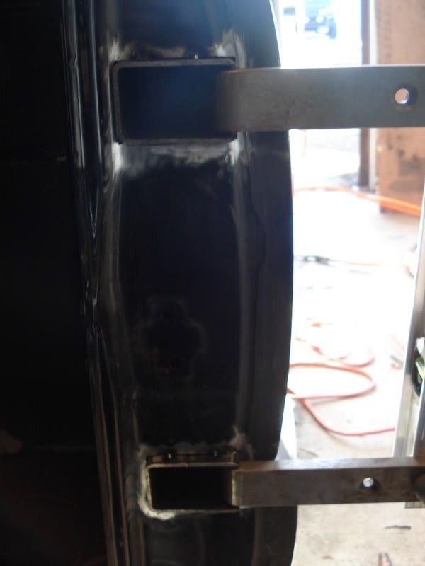

Looks like I forgot 2 of them.Here ya go.

It looks like your pockets arent lined up properly. Put a level on the actual pockets you welded in and check their level. It seems that the bottom hinge needs to be moved slightly right( or counter clockwise).
