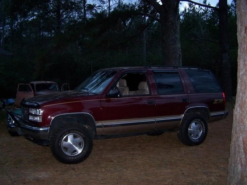

Before
After
2 1/2in in front and 2in out back, might change back to 3in later

hard to tell but before and after
