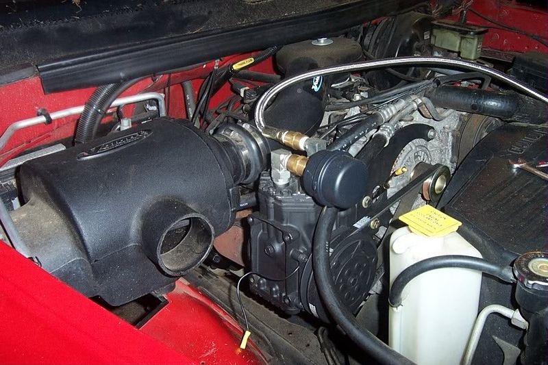

Kinda in a bind and wantin a little help. Got a 318 in my 01 Ram and was wonderin if anyone has installed an engine driven comp.? got an idea for where to put it but dont know if it will mess with the idler pulley? Any pics and info will be greatly appreciated.

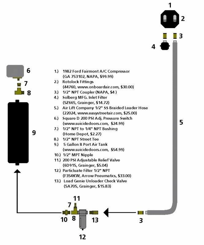

i converted my factory sanden comp. to engine drive you need an inline oiler and water seperatorand a check valve on your supply on your tank turn the oiler way up and it should be fine mine works great with no problems yet

Can u put a pic of that stock ac comp. u have so I can get an idea of where to put the oiler and setup. if I dont go with the york

I will GIVE you the files that you can get laser cut for edc brackets. I will also GIVE our a parts list too.
i help out my fellow ram owners as best as possible.
here are more pics
