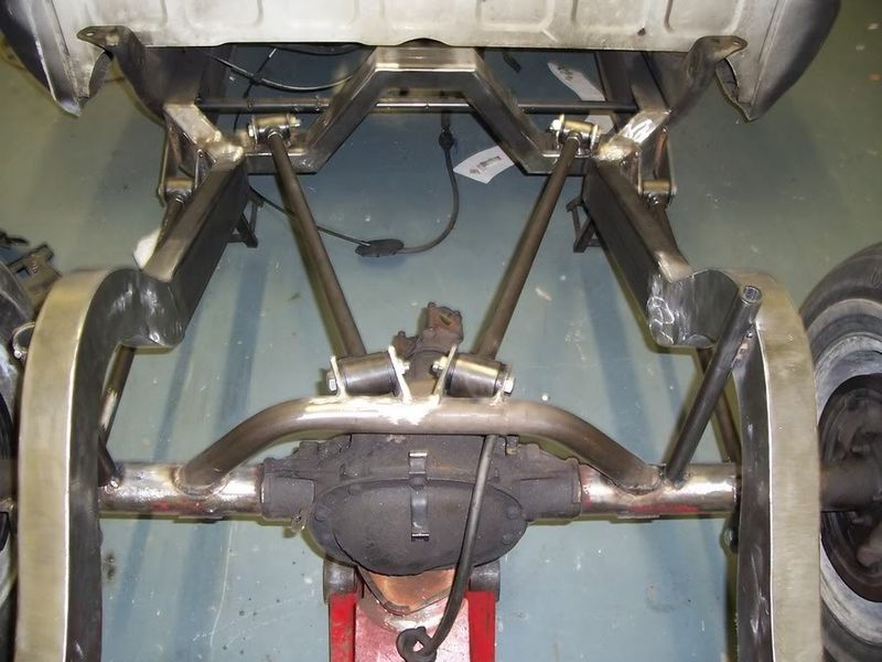

DO NOT WELD TO YOUR DIFFERENTIAL. you are gonna have to make something like this. if you weld to that cast your brackets will break. and then you will be no better than the guy you bought the truck from

He's right, if you aren't careful about the angle of your link bars (at HALF travel) you can have some really strange driving conditions. Roll steer is a by-product of link location, from above and from the side. So do some homework befor you start cutting into your truck.
If you want a copy of my rear suspension article IM me your e-mail and I will send you a copy.
