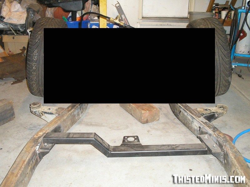

TwistedMinis's avatar
TwistedMinis
Working with about 4" of space under the floor.
It could be built out of 1x2 tubing to save more room, and possibly notched over the exhaust.

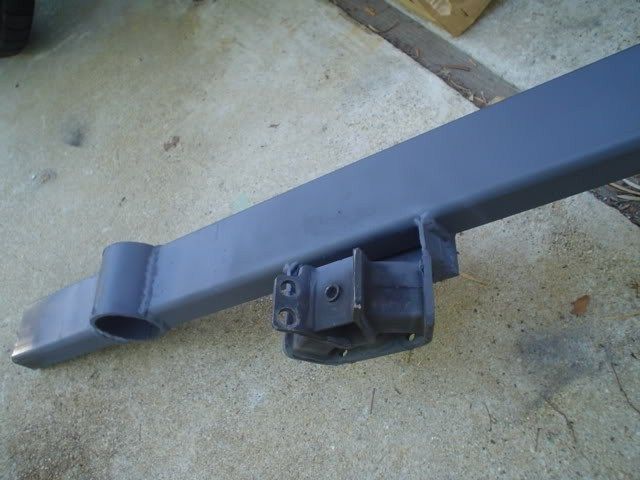

GFreeman's avatar
GFreeman
heres mine i made for my taco
s10
