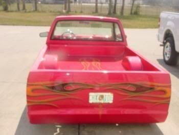

only pic of it i could find but i wanna do this kind of taillight setup, oh not the same design of course
So Tex Customz's avatar
So Tex Customz
is this candied plexi glass or does it have red lenses???
dragthatbitch
red acrylic glued to the back of the clear acrylic lenses.
