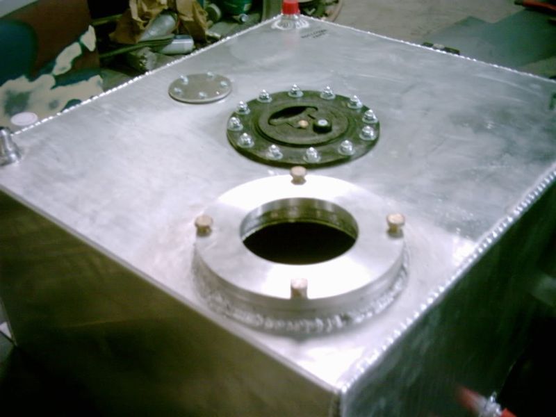

Lowpuppy
are u tryn to mount the stock pump into a fuelcell, this one is a 16 alluminum cell from summit and i had a piece machined to where i could mount the pump in the cell and welded it on, the pump colapes enough to where it will work perfect. if u dont wnt to do this u can buy cell with senders already in them and wire them up to the gauge.
