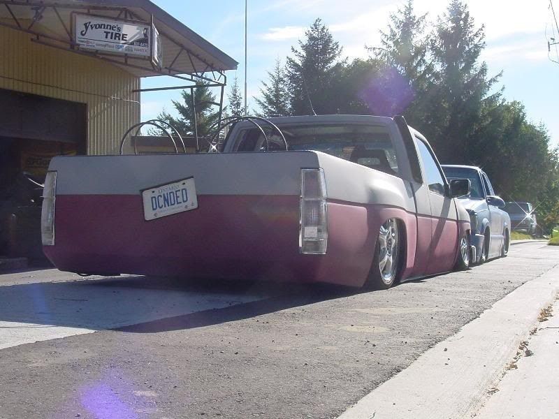

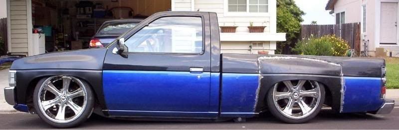

THE RED AND WHITE HB IVE BEEN TOLD IS PATHFINDER THE OTHER TWO YOU CAN TELL ARE FENDERS BUT IT LOOKS LIKE THE BULDGE IS A LITTLE CANTED TO ME BUT IVE HERD THATS WHAT IS DONE AND THE TWO WITH THE FENDERS ARE EACH DONE A LITTLE DIFFERNT METHOD IF YOU LOOK CLOSELY

That rearward slope from using the 4x4 fenders might look really good when it's all done- I can't wait to see that!

yo yo the red and grey one is 4x4 front fenders , using the front fenders is easier due to not having to deal with a seam from the pathy door let alone cutting that off the pathy nicely, also i personally like the fenders sloping forward but to each his own hope that helps!!
