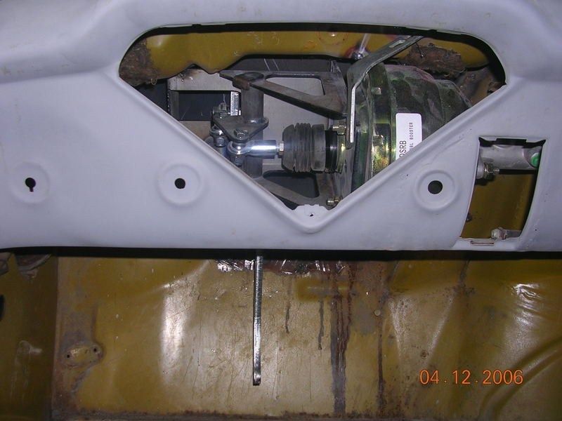

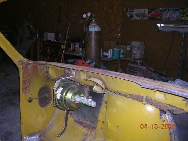

I got mine from Kugel Komponents works well.......

hey kyle, go to a junk yard and look at some full size vans. they come that way from the factory. you can get the linkage and the whole set up for real cheap

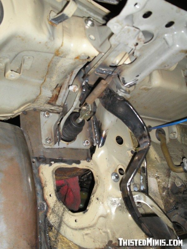

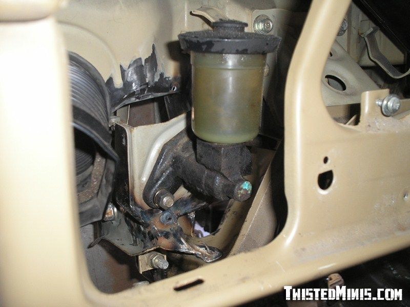

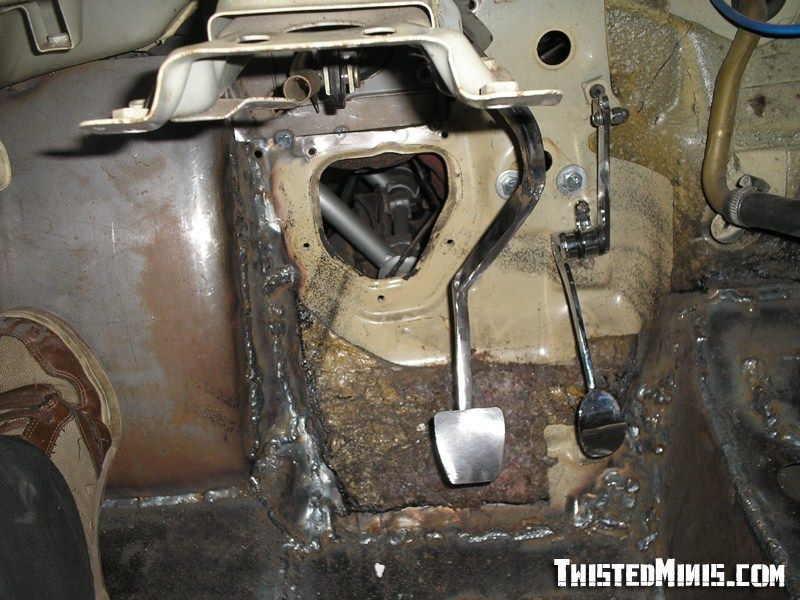

I put my clutch master under the dash.
And I just moved my brake booster up and over and modded the pedal.
