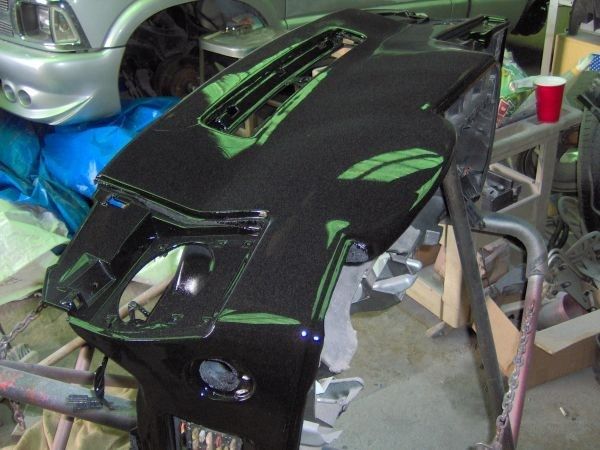

Yeah Pretty Much We Primered mine and sanded it and primered it again and sanded it several times to get all the textured stuff off so it looks smooth i think they look better like thathttp://www.streetsourcemag.com/uploads/Ownerprofiles/S10drggn2/582006111552AM2781.jpg>
S10drggn2's avatar
S10drggn2
Here
